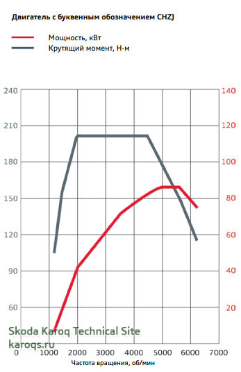

Внешняя скоростная характеристика двигателей 1,0 л TSI:

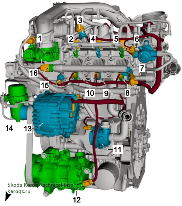

Skoda Karoq 1.0 TSI petrol engine, CHZJ from the front
Бензиновый двигатель 1,0 л CHZJ, вид спереди
1 - Throttle valve control unit GX3
2 - Gas inlet valve 1 N366 (for natural gas vehicles)
3 - Temperature and pressure sensor for gas manifold strip GX21 (for natural gas vehicles)
4 - Gas inlet valve 2 N367 (for natural gas vehicles)
5 - Gas inlet valve 3 N368 (for natural gas vehicles)
6 - Control valve for fuel pressure N276
7 - Suction pipe encoder GX9
8 - Injection valve for cylinder 3 N32
9 - Injection valve for cylinder 2 N31
10 - Injection valve for cylinder 1 N30
11 - Pump for charge air cooling V188
12 - Control valve for air conditioning compressor N280
13 - Alternator with voltage regulator CX1
14 - Vacuum pump for brake V192
15 - Oil pressure encoder G10
16 - Fuel pressure encoder G247

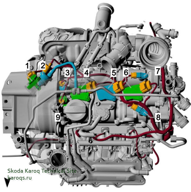

Skoda Karoq 1.0 TSI petrol engine, CHZJ from the top
Бензиновый двигатель 1,0 л CHZJ, вид сверху
1 - Charge pressure sensor GX26
2 - Solenoid valve 1 for activated charcoal filter system N80
3 - Valve 1 for camshaft adjustment in outlet N318
4 - Ignition coil 1 with output stage N70
5 - Ignition coil 2 with output stage N127
6 - Ignition coil 3 with output stage N291
7 - Signal encoder 3 G300
8 - Signal encoder G40
9 - Valve 1 for camshaft adjustment N205

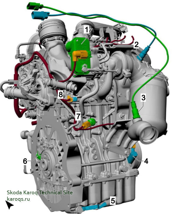

Skoda Karoq 1.0 TSI petrol engine, CHZJ from the rear
Бензиновый двигатель 1,0 л CHZJ, вид сзади
1 - Charge pressure regulator V465
2 - Lambda probe 1 before catalytic converter GX10
3 - Lambda probe 1 after catalytic converter GX7
4 - Valve for oil pressure control N428
5 - Oil level and oil temperature sensor G266
6 - Engine speed encoder G28
7 - Knock sensor 1 G61
8 - Coolant temperature encoder G62
