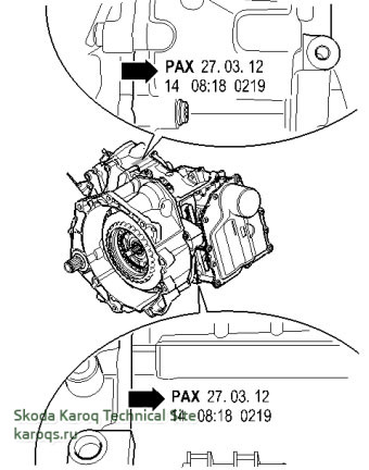

Location of identification characters on the gearbox
Example for a gearbox:
The gearbox code letter (arrow) is located at the top and bottom of the gearbox.
PAX - gearbox identification characters
27.03.12 - production date 27th March 2012
14 - Manufacturer's code
08:18 - time
0219 - serial number
The gearbox identification characters also appear on the vehicle data sticker.

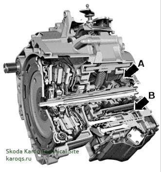

Filling capacity
The “7-speed double clutch gearbox DSG - 0CW” has two separate, different oil fillings
A - Area with gear oil (arrow A)
B - Mechatronics for dual-clutch gearbox J743, area with hydraulic oil (arrow B)
Gearbox
NOTICE
Risk of damage to gearbox.
- Only spare part gear oil should be used for the 7-speed double clutch gearbox 0CW -> Electronic catalogue of original parts .
- Other gear oils lead to malfunctions and/or gearbox failure.
- The gear oil level cannot be checked.
- The correct gear oil level can only be reached by changing the gear oil.
- An insufficient amount of transmission oil and overfilling affect the function of the gearbox, this can lead to malfunctions.
Mechatronics
NOTICE
There is a risk of damage to the mechatronics for double clutch gearbox J743.
Only the hydraulic oil available as a spare part may be used for the Mechatronics for dual-clutch gearbox J743 -> Electronic Catalogue of Original Parts. Other hydraulic oils lead to malfunctions and/or gearbox failure. The hydraulic oil level cannot be checked.
In the case of loss of hydraulic oil from mechatronics, the correct oil level can only be adjusted by draining the old oil and filling up with new oil.
During assembly work, the mechatronics must be sealed oiltight. An insufficient amount of hydraulic oil and overfilling affect the function of the mechatronics, this can lead to malfunctions.
08:18 - time

Filling capacity
Gearbox
| Area with gear oil (Arrow A) | |
| New filling | 1.7 l |
| Replacing | Filled for life, no change Oil change only when carrying out repairs if the gear oil was drained. |
| Lubricant | Gearbox oil for double clutch gearbox 0CW part number -> Electronic Catalogue of Original Parts |
NOTICE
Mechatronics
| Area with hydraulic oil in the Mechatronics for dual clutch gearbox J743 (Arrow B) | |
| Change volume after repair | 0.9 ltr. |
| Replacing | Continuous filling, no change required Oil change only when carrying out repairs if the gear oil was drained. |
| Lubricant | Hydraulic oil for Mechatronics for dual-clutch gearboxes Part number -> Electronic Catalogue of Original Parts |
| The mechatronics for double clutch gearbox is assigned to the gearbox identification characters -> Electronic Catalogue of Original Parts . The new mechatronics is already precisely filled with oil at the factory. |
NOTICE
