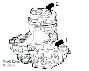

Location on the gearbox
Identification characters and production date - arrow (1)

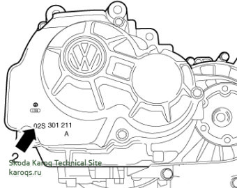

Identification of the gearbox - arrow (2).
Example for identification of gearbox 02S

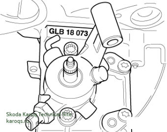

Example for identification characters and production date of the gearbox
Example: GLB 18 07 3
GLB - Engine identification characters
18 - Day
07 - Month
3 - Manufacturing year 2003
Additional data provides information about the production facility.
The gearbox identification characters also appear on the vehicle data sticker.
