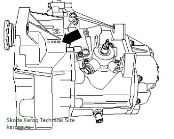

Location on the gearbox
Identification characters and production date - arrow (1)
Identification characters and production date of the gearbox - arrow

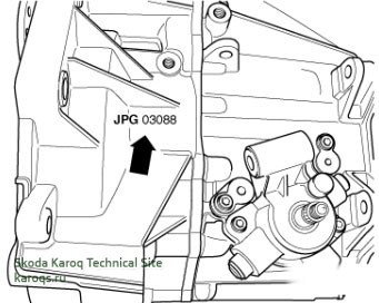

Example for identification characters and production date of the gearbox
Example: JPG 03 08 8
JPG - Engine identification characters
03 - Day
08 - Month
8 - Manufacturing year 2008
Additional data provides information about the production facility.
The gearbox identification characters also appear on the vehicle data sticker.
03 - Day
08 - Month
