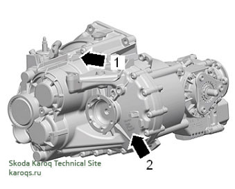

Identification of the gearboxes 02Q, 0BB and 0FB. These gearboxes are 6-gear gearboxes MQ350 and vary only in terms of the technological design of the selected parts. Identification characters and production date.
Four-wheel drive
Identification characters and production date arrow (1).

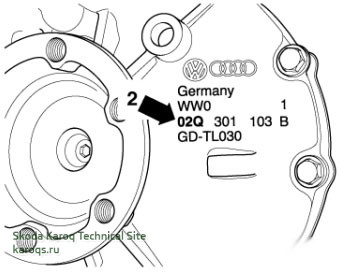

Identification of the gearbox (02Q, 0BB, 0FB) arrow (2).
Example:
Gearbox 02Q arrow (2)

Four-wheel drive
Example:
